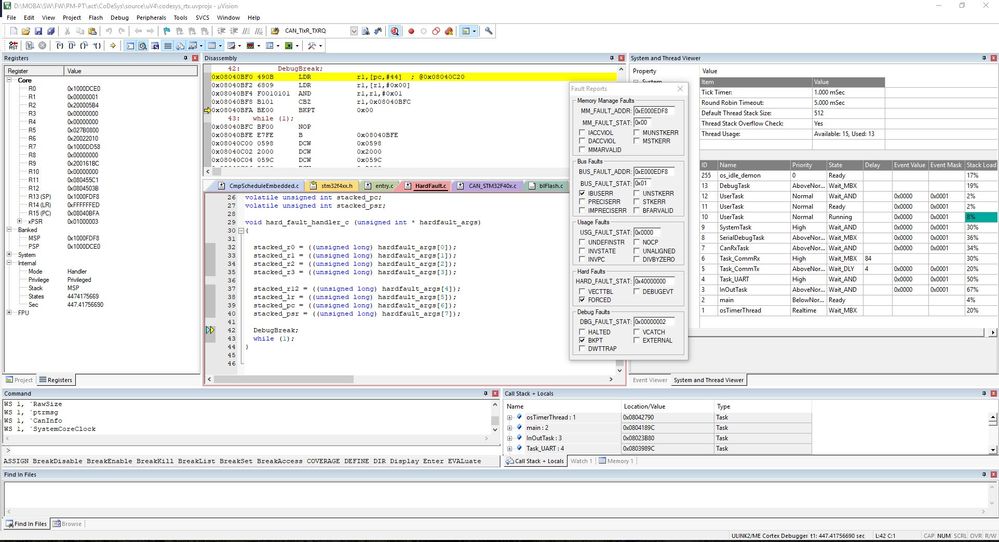

I need help, because we are facing hard fault with the STM32F427 MCU.
Same software over some MCUs works perfectly, over someother crash and we are not able to understand the reasons.
Attached screen shot of debugging sections.
Any Idea?

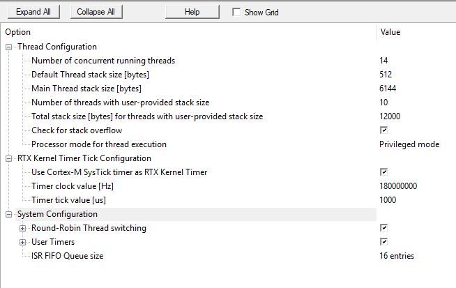

I still suspect a stack overflow, in particular the processor stack (NOT the RTOS task stacks).
This size is 'hidden' in the uVision project settings.
Doesn't uVision have a stack check feature ?
This consists usually in an initialisation of the stack with a specific pattern.
If you can't see this pattern anymore when hardfaulting, the stack is too small.

The 'fault report' window in your images already contain the relevant SCB register content.
IMHO no great need to improve the fault handlers for that purpose.

Ok, but you keep posting screen shots not showing the registers at the hard fault. I don't see content of stacked_*** variable, nor the stack memory. You need to dig backward, not just die at DebugBreak();
If you have console output working, consider dumping registers
Have routines checking your own stack depth usage. Make sure local/auto variables are cleared properly also, as will contain random junk.
