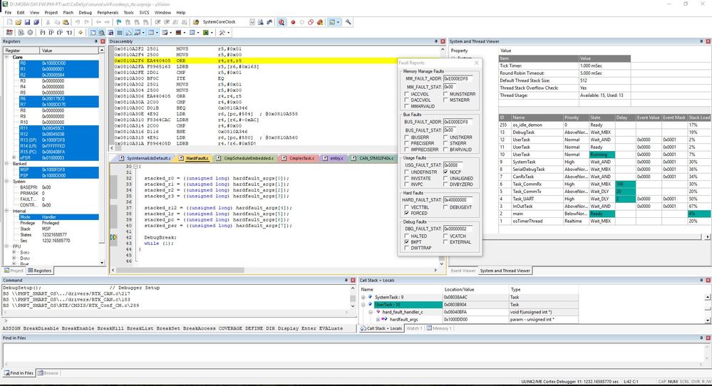

I need help, because we are facing hard fault with the STM32F427 MCU.
Same software over some MCUs works perfectly, over someother crash and we are not able to understand the reasons.
Attached screen shot of debugging sections.
Any Idea?

yes, the very strange is some board yes and some other not.
I've tried to replace the MCU and that board is now working properly, no more problems like before.
Some how I've the feeling it is the MCU having something, but honestly I'm not sure.
The place is not always the same, it looks that somehow there is a repetition of 5/6 different value of program counter, but...
Errors are NOCP, UNDEFINSTR, INVSTATE talking about Usage Fault, few times I get also Bus Fault PRECISERR.
Another strange things happening, is that if I place the PC to the value got by the hard fault handler, sometime the instruction is executed if I do that step by step, sometime that line is not executed, it looks the program stack there and no way to go further.
Where to see SCB register?
About interrupts, I was thinking about that, because a way to have more frequently the problem is to increase the amount of Tx/Rx interrupt fron CAN BUS interface. But again, very strange that on some board it happens quite easy and on some other board never.

We don't find the code that is faulting, because the PC is always different and it goes in place where code is normally working.
About hardware, could be a point. On one board only, the only one where we tried, by changing the MCU the problem looks solved. Maybe is not the microcontroller, but a soldering of a VCAP pin as you suggect.
I try to look.
