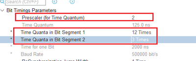

At first check at your ioc file, I don't recommend these values for CAN bit timing:
hcan1.Init.Prescaler = 16;
hcan1.Init.TimeSeg1 = CAN_BS1_1TQ;
hcan1.Init.TimeSeg2 = CAN_BS2_2TQ;
BS1_1TQ and BS2_2TQ are very low. You need to increase them as much as possible by decreasing the prescaler as much as possible.
I recommend these values for 500kb/s:

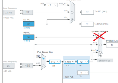

Also, we don't recommend HSI as clock source when using CAN in Normal mode. You need to use HSE with an external crystal otherwise you may face communication issues.

Thanks to both of you, both answers were very helpful!
With the bit timing provided by @mƎALLEm, the TX no longer failed. With the code from @Karl Yamashita , the reception also worked.
