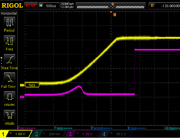

Bellow is a scope image, yellow is the 3.3V supply line, and purple is the reset pin.
The measurements where taken at 500uS/1V division.
I dont have capacitor on the reset pin
What do you think?

I would say you definitely need a cap, is that 1uSec from power supply at 2.5v to Reset up ?
did you check the reference manual ?
page 29 of the F427 data sheet, VACAP has to be stable before Reset, can you check that ?
you should check pages 25-29
Page 97, NRST Pin
page 138: You need a 0.1uF, and no resistor ??
Table 59. NRST pin characteristics shows:
Time of NRST_OUT Generated reset pulse duration Internal Reset source 20 - - μs
I can't see this 20uS running on your scope.
