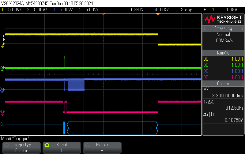

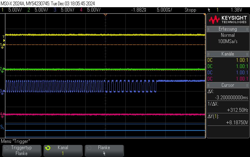

Ok, it took me a while to advance on this problem. I redesigned my project so that all access to DMA1 are made from a timer interrupt and therefore never at the same time. The problem still occurs.
I recorded the signals when the DMA access is interrupted (1: Test-Signal 2: MOSI 3: SCK 4: Chip Select). The first picture shows the complete SPI access. The second shows a close up of the moment the SPI access stops. One can see that just at that moment the clock signal frequency changes.
I then tried to reset one by one the DMA, the SPI and then the Clock through the RCC AHB1 peripheral reset, resp. RCC APB1 peripheral reset. But I could not get the SPI running again. I again had to reset the complete board.
One note on the system clocks. After leaving the stop mode the software has to reset and setup the clock registers. This is library code from system_stm32f4xx.c, function SystemInit(). This happens before the first SPI access is started.

2024-12-10 5:27 AM
The DMA is not running in stop mode. It is started approx 1msec after leaving stop mode.
