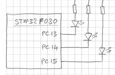

Is it OK to use these pins as current sinks for driving LEDs ?

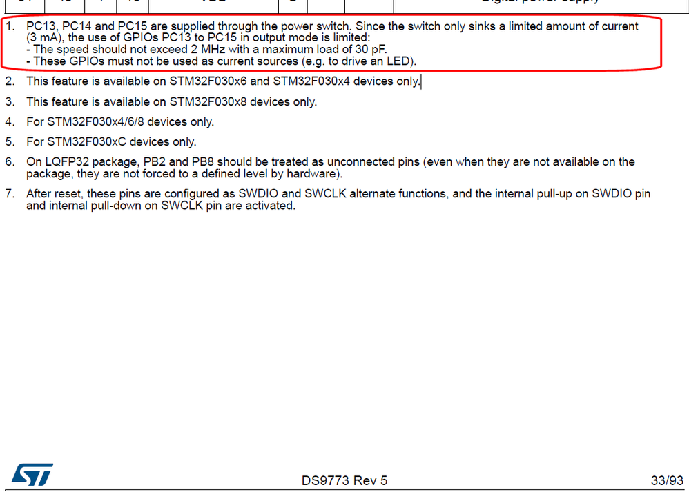

Hello @Andrew Neil
As it is mentionned on the 3rd line of the note on the screenshot:
"These GPIOs must not be used as current sources (e.g. to drive an LED)." For Curent sink, i will check this and get back to you ASAP.

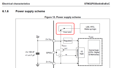

2024-09-05 10:57 AM
plus the reason stated for the limitation is that these pins are fed "through the power switch", and that's what limits their sourcing capabilities.
I presume this is "the power switch":
On that basis, if it's the whole story, sinking should be OK ... ?
"the switch only sinks (sic?) a limited amount of current" sounds like a typo, though?
2024-09-05 1:18 PM - edited 2024-09-05 1:36 PM
What's gating it, or how robust the wiring/metalization is feeding it across the die.
That was definitely my "hot-take" on the documentations wording, and that the return-path on the common VSS side was significantly more substantial, and not switched/gated.
The geometry of the IOCELL's transistor might also be smaller/slower, I vaguely recall a +/- 3mA specification in some STM32 family docs.

2024-09-17 5:50 AM
Hello @Andrew Neil @Tesla DeLorean @AScha.3
Sorry for my late replay, I just received this answer from the concerned person:
" The switch is only impacting GPIO source capabilities. No limitations if IO is set in output low level."
Best Regards.
STTwo-32
2024-09-17 5:54 AM
Thanks - it would be helpful if that could be clarified in the datasheet.
