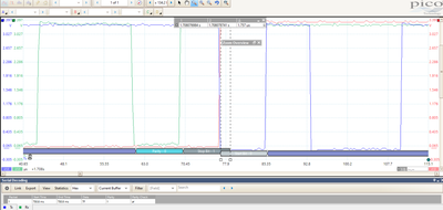

we use STM32F413RGT6 as slave board communicate through rs485 bus. In application, we drive rts by emulated gpio. We use for update of the board HW uart bootloader. Due to weakness of the HW bootloader we face some problems during update on half duplex uart, because HW bootloader sometimes response sooner, than is complete msg send. Due to it we receive damaged ack, for example 0xb9 instead of correct 0x79.
