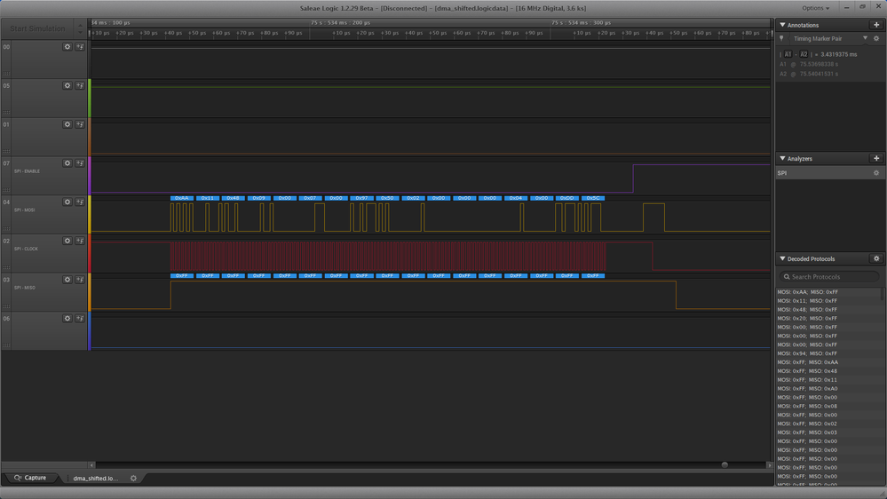

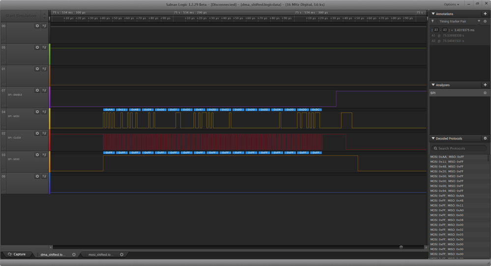

You can see that CLK signal has already started, but data on MOSI is delayed by 5 bits (not constant, can be 4, 3...).

Sorry I don't have the Saleae analyzer and don't intend to install the program. Can you please cut out the "previous" and "corrupt" transfer and place them next to each other?
[EDIT] Okay maybe it's not that necessary. Try to answer the following question first, and then perhaps mitigate it - if the signals are floating, try to set pullups/pulldowns as appropriate, especially to SCK [/EDIT]
Also, what is the SPI_ENABLE signal? And why are the SPI signals changing after the transfer ended?

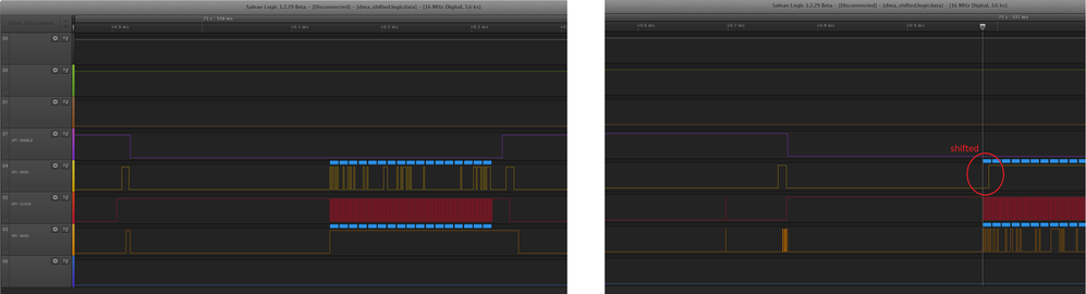

Combined previous--->corrupted transfers:
"Previous" closer view:

> After end of the transfer I execute disable and deinit SPI (including clock disable - RCC_APB2PeriphClockCmd) and change MISO/MOSI/SCK pins to INput mode with pull-down.
Okay, so don't do this. Leave the SPI on. And, as as you CPOL so that SCK is high on idle, don't use an pulldown, us a pullup to avoid any transition on SCK.
I'd say, the exact sequence how you re-enable the SPI includes a period, where the SPI is slave and its clock is floating, resulting in the internal clock-counter to be shifted out of 0 and remaining so even if switched to master. The bunch of pulses on MISO in the "corrupted transfer" at the moment when the _ENABLE signal goes low is IMO not a coincidence.
The SPI state machine is relatively fragile. SPI_CR1.SPE is always the last bit to be set.
