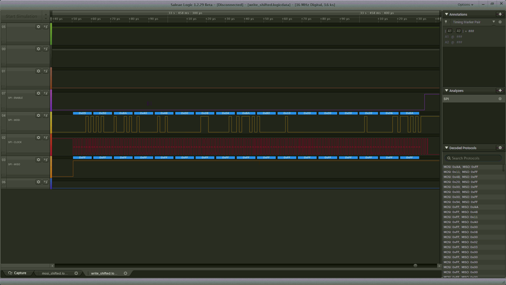

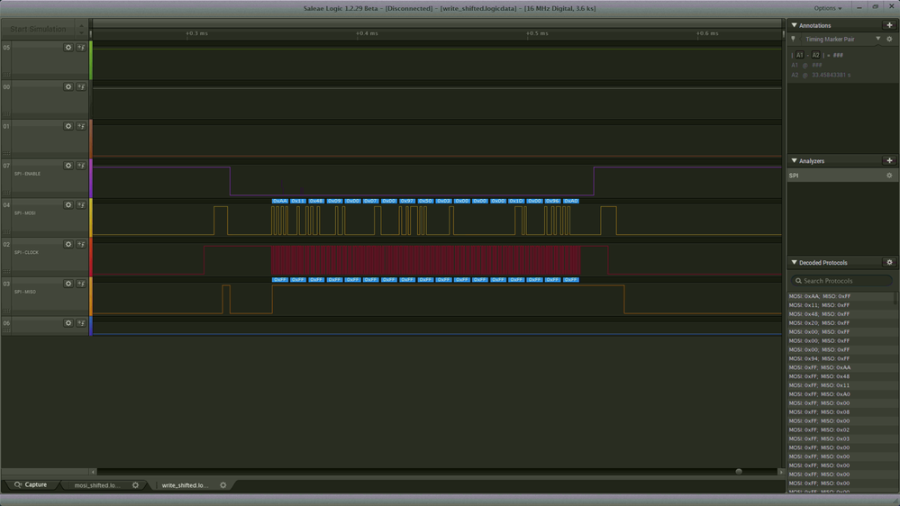

Here is an example of corruption:
You can see that CLK signal has already started, but data on MOSI is delayed by 5 bits (not constant, can be 4, 3...).

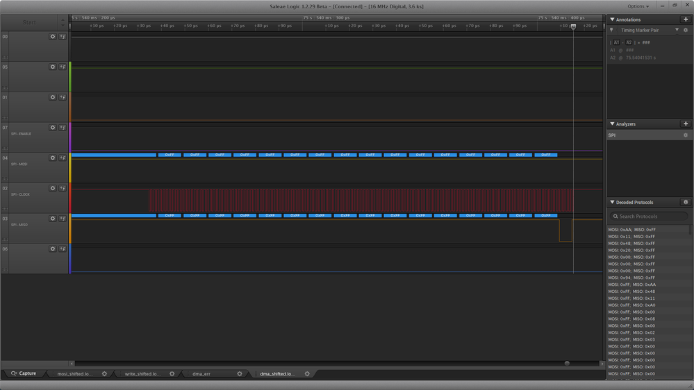

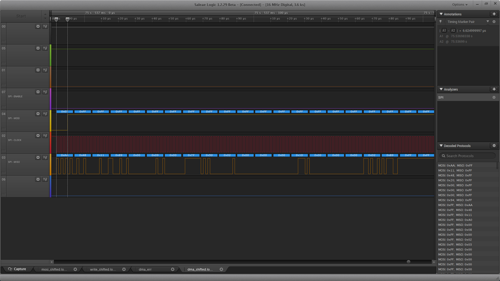

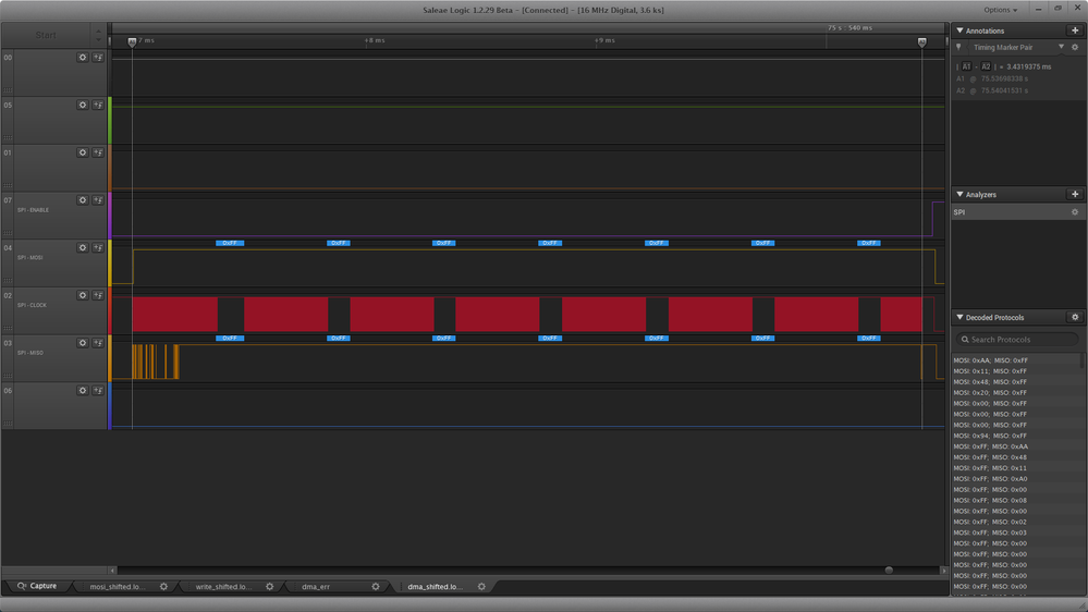

How entire transaction looks:
The beginning of it (in this case I send all 0xFF bytes):
And the end:
