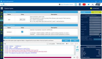

At this point I tried to find some help from STM32 Developers group on Facebook at first time, but without any luck.
What I search over Internet is that maybe the problem comes from RDP bytes and when I checked it, the value found by STM32CubeProgrammer is 0xFF, none of the possible values (0xAA, 0xBB or 0xCC).
I tried to change the value to one of the possible values and press the "Apply" button, but without success again. Below you will be able to find some screenshots related to it.

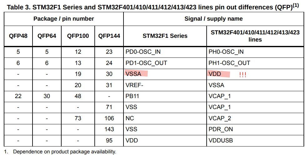

2024-06-25 5:06 AM - edited 2024-07-01 1:28 AM
For this you need to check AN4904 "Migration of microcontroller applications from STM32F1 Series
to STM32F4 Access lines"
The pinout difference, with LQFP64, is the VCAP pin on STM32F4 which was PB11 on STM32F1.
VCAP pin needs to be connected to GND over a 4.7uF ceramic capacitor:
Refer to the AN4488 "Getting started with STM32F4xxxx MCU hardware development"

2024-06-29 4:42 AM - edited 2024-06-29 3:51 PM
Nothing in AN4904 suggests that STM32F412RET6 is a drop-in replacement for STM32F103R8T7. I think you misunderstood what CubeIDE means by "compatible". It doesn't look like it's "compatible" at the pin level. i.e. you can't just solder a chip from another family in place.
ST may have kept "most" pins compatible between packages across families. But you only need one pin wrong to have your design fail:
Find a 100% pin compatible replacement that meets your needs, or re-spin the board (the necessary changes to layout should be minimal, so ST claims).

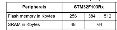

How much memory you require? F103 exist with many flash sizes

2024-06-29 6:54 AM
btw F103 ....up to 512K flash :

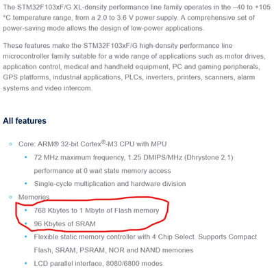

2024-07-01 7:36 AM
F103RG has up to 1 MB flash, 96 KB SRAM.
