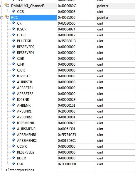

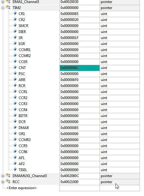

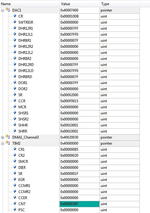

2019-09-11 11:15 PM
DAC and TIM2 registers: after first TIM2 trigger for 0x7FF:

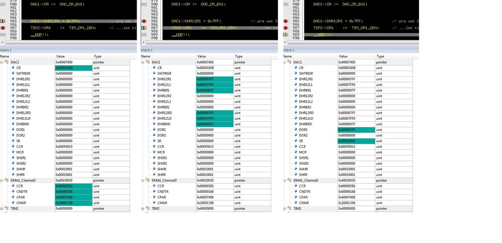

DAC trigger sequence (only once...):
