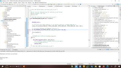

My issue is that when I add the OpenAMP initialization instructions to the task, the processor freezes.
if (MX_OPENAMP_Init(RPMSG_MASTER, new_service_cb)!= HAL_OK);
