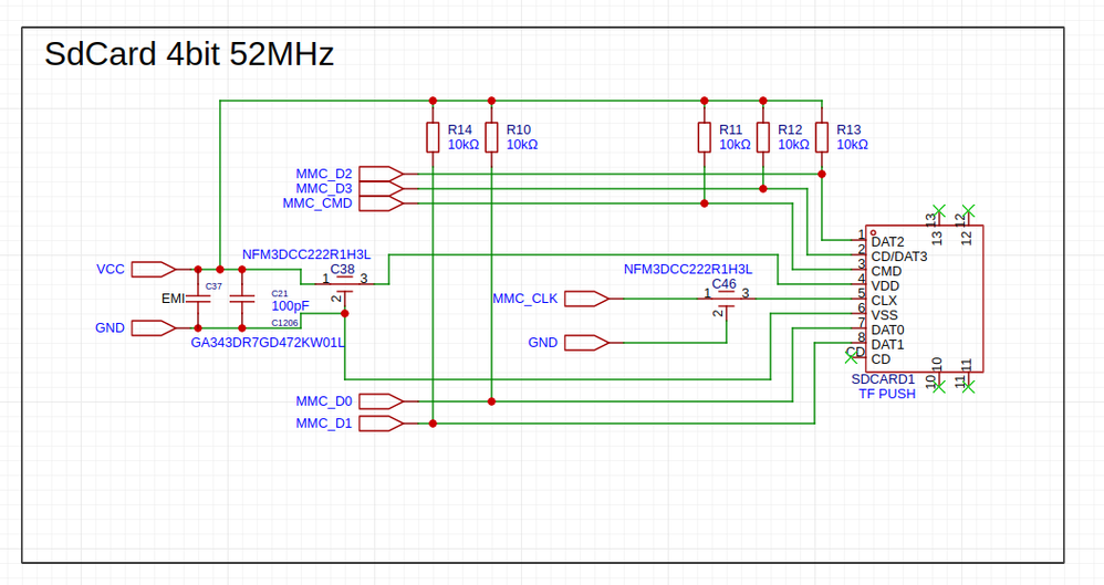

2024-02-16 9:00 AM
A schematic of the card might work better and a picture in expressing the circuit.
As @AScha.3 mentions, you want short/even cables, pull-ups a the socket, the WaveShare SDIO boards are a good example of an ideal circuit.
The F412-DISCO or one of the other EVAL/DISCO boards should have examples in Examples\Application\FatFS type subdirectories off the board trees. Sorry not a big fan of the CubeMX auto-gen approach. The BSP or MSP files should designate which GPIO is for Card Detect, and that's optional.
Debugging at the FatFS top-level is far less useful than at the DISKIO layer.
Make sure HSE_VALUE, PLL and clocking is set correctly for given board. For the F41x I'd disable SDIO HW Flow Control
2024-02-16 9:11 AM
This is the schematic of the SD card test board, and it works fine with Espressif.
