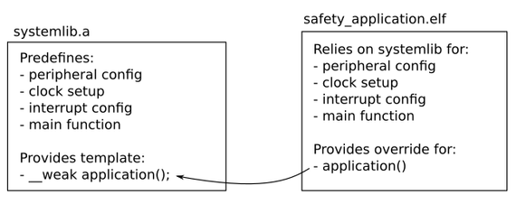

For that matter, I would like to statically compile everything, including peripheral configuration, interrupt routines, clock setup, main function, etc. and then subsequently have the application be provided externally as a single function .
My initial thought was to create a "system" project in cubeIDE that contains the entire system setup, main function, startup script, etc., along with the application defined as an empty __weak function, and then compile this project as a static library.
I would then create a secondary "application" project, to include the static system library, while overriding the _weak application method, with the business logic of the actual application being implemented. The "application" project would not be supposed to include any setup, main function, startup script, or anything, since this should all be available from the "system" library.

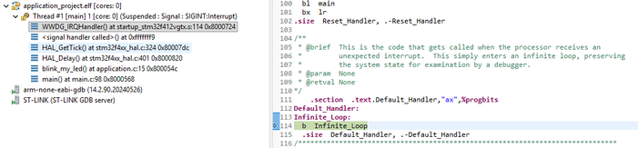

- I can get the board to run, and enter the main function, while single stepping through the application
- When I let the program run without single stepping, I get an exception that sends me to the Default_Handler in the startup script

Could you please inspect the call stack at the moment the default handler is triggered. By examining the call stack, you can identify the last function or instruction executed before the default handler was invoked, which often points directly to the source of the issue. Additionally, it is important to check the interrupt vector table to determine if any handler is missing or misconfigured.
You could perhaps check the source, by inspecting/reporting VECTACTIVE field in SCB->ICSR
You can instrument your library to provide a diagnostic build to identify what is going astray in the application.

I think it is a good idea to structure the project in an arduino like fashion with a loop and setup method, but I am still not sure how to organize the various code components so that the application programmer only has access to modify the elements that he is supposed to?

The ARM TRM or ST Programming Manual cover the *CORE*
The linker should permit the type of build you propose, but you'll need to be attentive. Establish why it currently isn't outputting viable code.
Inspect the objects, libraries and executable files with tools like OBJDUMP or FROMELF, confirm linkage, and what's imported/exported by each. Do a disassembly and walk that to understand why it might be failing.
Where the interrupt and exception handlers fit in this scheme?
It looks like you want to tightly control the "user application", then there are known methods for this. User/supervisor separation, MPU... trustzone. Reinventing a bicycle is fun, when you have time and resources.
