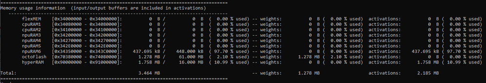

My understanding of the .mpool file, is that you are basically telling the `stedgeai` tool "This is my available memory, that I am letting the NPU use". If you want to increase the applications LENGTH of course you can, just adjust the .mpool accordingly to not use that region.
AXISRAM1_S (xrw) : ORIGIN = 0x34000400, LENGTH = 1536KMore than likely they left it at 1536K as there is 16M of external RAM
OR.. make sure the CPU doesn't use the RAM region when an inference is happening.
The NPU memory could be used for other things, as long as an inference is not happening.
Try test adjusting the .mpool and see what happens. Either edgeai will complain that it can't do its magic to use (and reuse) that RAM buffer or it will make do with what its been provided. More than likely this will just impact the inference time, as there are more operations and steps as there is less memory, or perhaps it will use memory which has a slower interface.
It all depends what model you want to end up using. For example with the object detection model, here are two examples of .mpool edits and the outputs:
Notice above it used more of the hyperRAM as some RAM regions were set to zero.

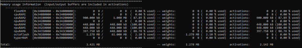

Here the hyperRAM was set to zero, and the RAM3 region was set to zero. The linker could then be adjusted to use that RAM3 region, and then it could allocate it to CPU buffers. I.e. Remapped the .noncacheable region or assign a new region.
I think this should do the trick?

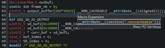

A quick update: It looks like we have to implement EWL_USER_MM to place the reference frame and frame buffers in external PSRAM instead - I've tried to document it fully here:
Is there any guidance on implementing EWL_USER_MM?
It looks like ST's bare metal VENC example just uses malloc for the reference frame and the buffers for the VENC. That will use up a lot of of the two 1024 KB banks of internal SRAM that are available to the MPU on the 400 MHz internal bus.
The solution seems to be to implement EWL_USER_MM to put the reference frame and buffers for the VENC on external PSRAM instead. External PSRAM should be fast enough for this.
