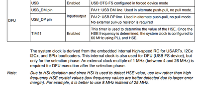

Are you using an external HSE oscillator?
Check this Application Note AN2606 which provides details on STM32F411 configuration in Table 67. STM32F411xx configuration in system memory boot mode.
