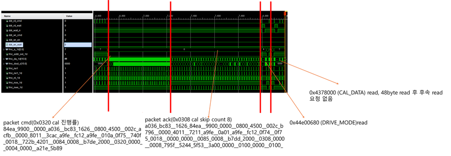

When the issue occurs, the waveform of the FMC bus was captured from the FPGA. The results show that while the FPGA properly prepares the SDRAM data for transfer, the MCU reads only the first 48 bytes during the burst read operation and then there is no further activity on the FMC bus.
