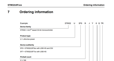

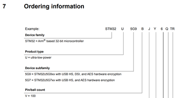

2025-03-29 5:17 AM
Dear @logstream76 ,
You can check at end of the datasheets the Ordering information. MIPI DSI is only available for STM32U5G/F9 version not for STM32U5G/F7 version
Hope it helps you.
STOne-32.

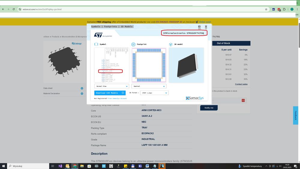

2025-03-29 6:27 AM
Thank you.
The schematic symbol shown in your e-store is misleading.
It shows that U5F7 also has DSI pins:
2025-03-29 7:18 AM
Dear @logstream76 ,
Thank you , we will check it ! A bit complex to handle common Libraries & symbols for different parts .
Ciao
STOne-22
