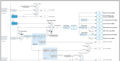

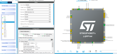

I am using the STM32F411 MCU and i am trying to generate PWM signal with fixed dutycycle and frequency.
clock configuration and timer settings is attached below.
When I set the PWM frequency to 10KHz and the duty cycle to 50%, I get the output as 10 KHz frequency and the dutycycle toggles between 50.00% and 49.97%. When setting PWM frequency to 40KHz and duty cycle to 50%, I get output as 40 KHz frequency and dutycycle toggles between 48.00% and 47.97%.

Try to get the prescaler to zero, and do all the division in the period

If you set prescaler so that timer's counter clock is 1ms, and you set ARR so that PWM frequency is 40kHz, the period is 1/40kHz = 25ms i.e. ARR=25-1 and the granularity of pulse width setting is 1ms. If you want 50% PWM, the calculation you made above (i.e. ((PWM_Dutycycle*Auto_Reload_Value)/100) = (50*25)/100 =1250/100 = 12 (notice the rounding in integer division), i.e. the pulse is ON for 12 ms and off for 13ms. That's 12ms/25ms=48% (as consequence of the rounding). With 1ms granularity (i.e. prescaler set to 72-1) you can't set the PWM more precisely; if you'd set CCRx to 13, you'd have 13ms long pulse i.e. 13ms/25ms = 52% ratio.
The solution is, as @Sarra.S said above, not to set prescaler to result in 1ms timer counter clock. As she said, simply set prescaler to 0, and then for 40kHz PWM you'll have ARR=(72 * 25) - 1, and the granularity is 1/72ms.
