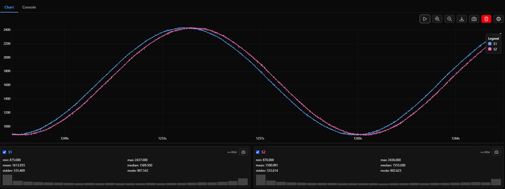

Hi, I need a little explanation about what is wrong behind my reasoning..
I am using STM32F411. reading, two inputs of ADC in scan mode over circular DMA triggered via TIM2 update event.
TIM2 is triggering ADC at 100KHz, so I have 50Khz sample rate per adc input. At input of both ADC channels I connected signal generator feeding 1Vrms sine @20KHz.
Everything works ok, I am using printf of both channels over (USB-CDC) as and I can see two sinusoide signals on serial plotter. I am using this serial plotter:
https://web-serial-plotter.atomic14.com/
Now the problem and confusion starts here:
If I change only TIM2 frequency to 10KHz, I am getting 10X lower sample rate also (now 5KHz pre channel, all checked with Logic Analyzer), but I still can see clear 20KHz sine at serial plotter, without degradation and this contradicts Nyquist theorem...
How is this possible and what I am missing?

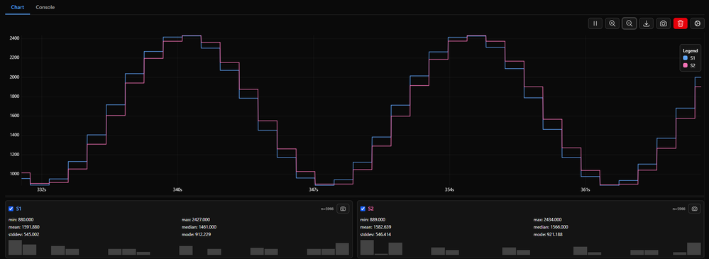

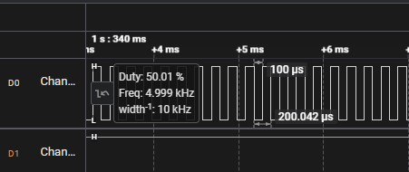

2025-11-16 4:56 AM - edited 2025-11-16 10:04 AM
Well I can see I am missing something here...
I am fooled by serial plotter, it prints slowly, it needs about 12 sec to print one sine cycle.
This is what I see with 20KHz input and only 10KHz sample rate.

/* USER CODE END 1 */This is my logic analyzer screenshot of LED_BUILTIN gpio:
So could anyone help me learn what Im missing?
2025-11-16 1:07 PM
This is with everything else the same, just TIM2 set to 1Hz, for experiment purpose.. So what I should conlude from this.?
2025-11-16 2:09 PM
PIcture tells you that at the adc input present non modulated sinewave unknown frequency,
but Freq.(Hz) = 1 x N + 1/15 = N + 0.066, where N -> 0....infinity
2025-11-17 5:02 AM
Hi, what do you think now, as I see TIM2 is working correctly.
2025-11-17 10:08 AM
I don't think all samples are making it into your serial plotter, thus the output is showing up as a sine wave, but not with the frequency you expect. That would be the expected behavior. I would look into how you're getting data out. Send it in chunks, not one at a time.
Printf hooked up to CDC directly is not a robust output mechanism, especially not with a 5ms delay between outputs.
