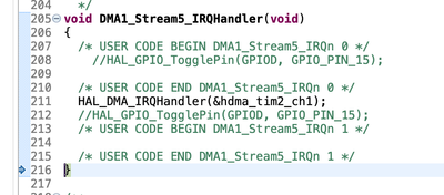

I checked first as you said, the DMA_Stream5_IRQHandler by toggling the LED:
void DMA1_Stream5_IRQHandler(void)
/* USER CODE BEGIN DMA1_Stream5_IRQn 0 */
//HAL_GPIO_TogglePin(GPIOD, GPIO_PIN_15);
/* USER CODE END DMA1_Stream5_IRQn 0 */
HAL_DMA_IRQHandler(&hdma_tim2_ch1);
/* USER CODE BEGIN DMA1_Stream5_IRQn 1 */
/* USER CODE END DMA1_Stream5_IRQn 1 */
}I gave a rectangular signal of 1 Hz on the PD15, and this IRQHandler is triggerd, since I see the LED blinking with also about 1 Hz.

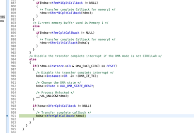

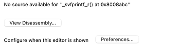

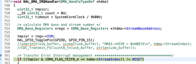

2025-11-21 2:14 AM
in debugging modus, it arrives "/* Transfer complete callback */", which means the transfer complete call back should be triggered, right? but after this point, the program dose not go back to main.c:
after this the program runs into:
then it comes back to my breakpont I set:
and so on.
the programm never enter the main.c again, strange.
