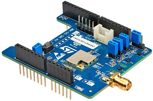

I created a pin table, and do actually have the CUBE LRWAN software building for it. You have to wire up the SWD header, and also nuke the firmware because USI has ROP enabled.
The board can then at least be free-standing, but the SX1272 and smaller L0 makes it somewhat less appealing than the Murata. Still enough space to make a Mote using the on-board sensors.

The onboard sensors would be interesting, but I cannot find any documentation ANYWHERE that outlines what sensor is connected how to the USB module (well, the ST source does show how things are connected to the Arduino headers).
Also no description of the SBs and jumpers ...
