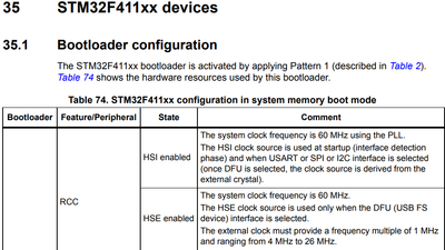

I've created a custom STM32F411CEU6 Board with external HSE und LSE. While the HSE works when running my user program, the Bootloader hangs within boot phase (i think).
When starting bootloader, BOOT0=1 und BOOT1=0. I powered direcly on VDD, no USB. I received no answer on both uarts after sending 0x7F. I also can't connect via stmcubeprogrammer. Only can only connect with stlinkv2.
I think it may be a hardware issue, but I can't find a solution.

No, i havn't such a crystal in that footprint. I choosed the 25Mhz crystal because of the black pill board. It uses the same frequency and all works fine. AN2606 mentions that the external clock can be up to 26 Mhz.
