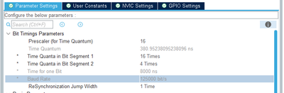

Thank you for the sharing.
I suggest this timing configuration for a system clock of 42Mhz with 125kb/s a CAN bitrate standard value:
The updated ioc file in attachement.
2025-03-26 6:58 AM - edited 2025-03-26 7:19 AM

2025-03-26 7:18 AM - edited 2025-03-26 7:21 AM
2025-03-26 7:26 AM
Thank you very much.
Now I found it in the RM. Next time I should read the documentation and not only use standard values.
