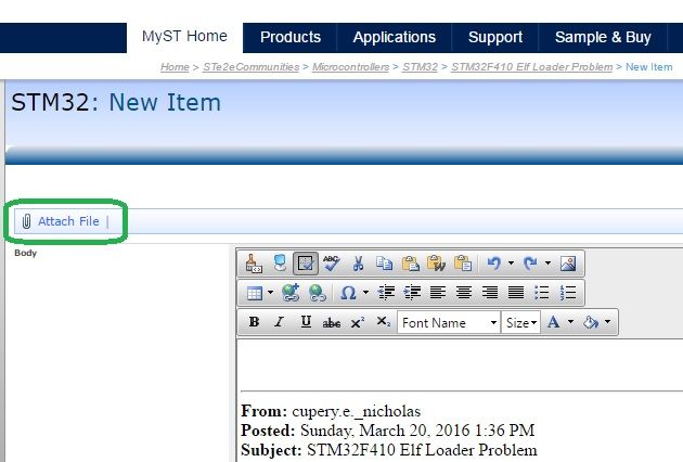

The ST-Link Utility (STLU) program does not, in fact, deal in .ELF files. I was trying to get it to load a .BIN version of my project. (I have VisualGDB set to generate both a .ELF and a .BIN for everything.) When STLU generated that MessageBox saying ''The elf loader is bigger than the RAM size'', it was trying to load the .BIN not the .ELF. My conclusion: the error message has little or nothing to do with the actual error. Also, please remember that I got the same error message from STLU when I told it to ''erase chip'' -- which would/should have nothing to do with my project at all. Note that VisualGDB DOES successfully load my project; it just cannot RUN the loaded image under the debugger. In case you are not familiar with VisualGDB, let me just mention that we are talking about VisualGDB conning Visual Studio into invoking the GDB debugger from the GNU ARM toolchain to talk to the on-chip hardware debugger that is part of the ARM Cortex M4 specification. Thus, it appears that it is the on-chip hardware debugger that does not like the chip! Yeah, hard to believe... You didn't see any attachments to my message because I have yet to figure out this, um, enigmatic forum software. (Someone less charitable than I might have said ''demented''.) I did try to attach some evidence, but the message got posted before I came close to figuring out how to attach anything. Meanwhile, I think the thing to dwell on here is the fact that STM's own ST-Link Utility doesn't like STM's own STM32F410 chip, and won't even erase it, and issues an insane error message when it tries. Something seems rotten in STMland. Note that I first suspected an error (on my part) concerning BOOT0, but I have checked that carefully (and I now don't even think BOOT0 could cause this problem anyway). Let me explicitly state that I have BOOT0 on my STM32F410CBT6 connected to ground through a 1k resistor. At this point, I would very much like to see someone, anyone, inform me that he has successfully incorporated an STM32F410CB into a working project. eNick2016-03-20 7:01 AM

that incorporates the F410, and I have ordered one that should arrive tomorrow (Friday 25Mar16). I should learn something from that. I haven't been ignoring you for four days, Clive. When you added that 4th post to this thread on 20Mar16, this insane forum software neglected to bump the post-count from 3 to four. Whan I post a new message, I am semi-religious about checking for developments several times per day, but I have been relying on the thread post-count (which apparently doesn't work around here). Speaking of insane STM forum software, yesterday I also posted an official request for tech support on this issue in the Support section of the official STM website. That software issued me a Ticket Number (TECH17108), then briefly flashed a message saying my issue already appears 16 times in their Knowledge Base, and then thoroughly resisted all my attempts to look at that issue (or any other issue) in the KB. This morning, I logged into the official website Support forum again and could not find any reference to my TECH17108 ticket at all. (I also tried again, and failed, to see ANYTHING in the STM Knowledge Base.) I can't even figure out if THAT forum is the same forum as THIS forum, which would imply that the STM forum is somehow ''My'' STM forum. In a couple of hours, the STM Tech Support telephone hours will start, and I will call them again, this time with a Ticket Number. If I ever get a cogent answer, I will post it here. - eNick2016-03-24 3:58 AM
