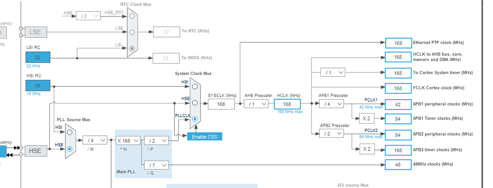

My clocks are configured as following:
As you can see, the APB peripheral clock is set to 84Mhz.
I have configured the ADC sampling time to be 480 cycles. I am using 9 channels for ADC. Does that mean that in order for all 9 channels to finish DMA conversion it will take 480*9 = 4320 cycles.
If one peripheral clock is 0.0119 micro seconds ( 1/84Mhz), does that mean that all 9 channels will complete the DMA conversion in 0.0119*4320 = 51.408 micro seconds?

2022-05-30 3:35 AM
Yes but you must also include the conversion time which is 12 cycles per acquisition.
If ADC acquisition is in 9 channel in serial then DMA conversion time = (1/84MHz) x 9 x (480 +12) = 52.71us
At each channel acquisition, DMA transfert is done in parallel, expected for the last one...so extra cost is about couples of bus clock cycles...
Again, depending on your application, you can reduce the FADC to increase the sampling time to fit your application accuracy requirement.
