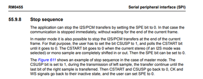

2025-09-03 9:36 AM
Hello @Vmanne
This is the stop sequence described in the reference manual.
2025-09-03 9:36 AM
Hello @Vmanne
2025-09-03 9:51 AM
Thank you Saket_Om,
also I guess, my testszenario is not very practical, since the application would always use a double buffer and a circular dma.
But I did not read the "stop sequence" topic.
Regards
Vmanne
