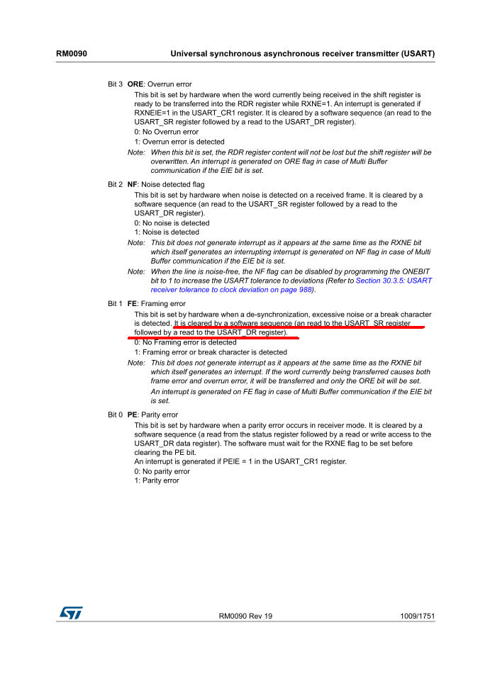

2022-05-05 4:18 AM
I have tried as suggested by this documentation:
void USART6_IRQHandler(void)
/* USER CODE BEGIN USART6_IRQn 0 */
if(READ_REG(huart6.Instance->SR) & USART_SR_FE ){
printf("frame error is set \n");
READ_REG(huart6.Instance->DR);
/* USER CODE END USART6_IRQn 0 */
HAL_UART_IRQHandler(&huart6);
/* USER CODE BEGIN USART6_IRQn 1 */
/* USER CODE END USART6_IRQn 1 */
}After doing this. I cannot believe but the communication now works without any issues. When my ESP32 microcontroller starts, it causes the STM32 USART to go into the Frame error state but I read the SR and DR registers and it clears itself. After that, I can communicate between 2 devices without any issues!
2022-05-05 4:27 AM
If the FE flag just occurs once, due to other initialisations impacting RX line, you could also try to call the macro for resetting FE flag, just prior starting your reception (i.e. prior calling HAL_UARTEx_ReceiveToIdle_DMA(&huart6,aRxBuffer6, RXBUFFERSIZE);
=> See __HAL_UART_CLEAR_FEFLAG(__HANDLE__) in hal_uart.h
(does basically what you added into your IRQ handler).
