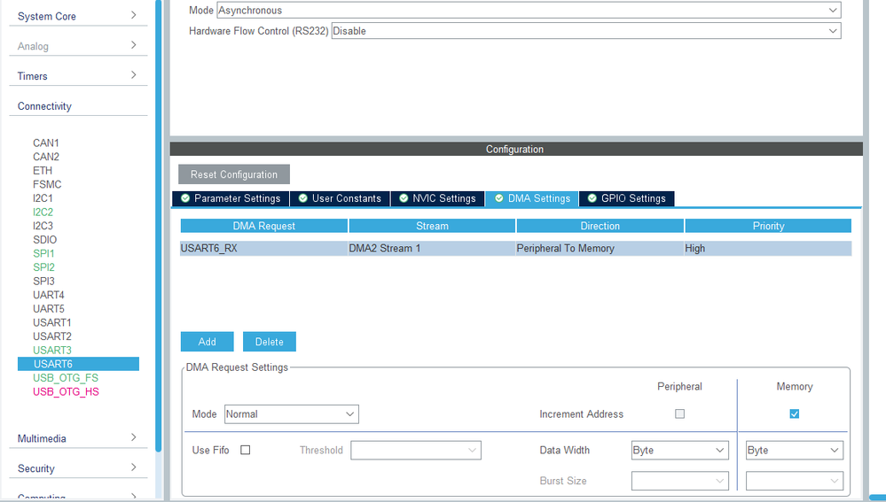

I have configured 2 UARTS both are configured to using HAL_UARTEx_ReceiveToIdle_DMA.
My init functions:
HAL_UARTEx_ReceiveToIdle_DMA(&huart3,aRxBuffer, RXBUFFERSIZE);
__HAL_DMA_DISABLE_IT(&hdma_usart3_rx,DMA_IT_HT);
HAL_UARTEx_ReceiveToIdle_DMA(&huart6,aRxBuffer6, RXBUFFERSIZE);
__HAL_DMA_DISABLE_IT(&hdma_usart6_rx,DMA_IT_HT);void HAL_UARTEx_RxEventCallback(UART_HandleTypeDef *huart, uint16_t Size)
if(huart->Instance == USART3)
memset(aMainBuffer, 0, sizeof(aMainBuffer));
memcpy(aMainBuffer,aRxBuffer,Size);
Command_parser(aMainBuffer,Size);
HAL_UARTEx_ReceiveToIdle_DMA(&huart3, aRxBuffer, RXBUFFERSIZE);
if(huart->Instance == USART6)
memset(aMainBuffer6, 0, sizeof(aMainBuffer6));
memcpy(aMainBuffer6,aRxBuffer6,Size);
Command_parser_uart6(aMainBuffer6,Size);
HAL_UARTEx_ReceiveToIdle_DMA(&huart6, aRxBuffer6, RXBUFFERSIZE);
I am sending some data from amother device via the USART6. I have even connected the logic analyzer and I can see the data go through, but for some reason the dma interrupt does not fire for usart6. Can someone help me understand what is happening and what is the best way to debug this?

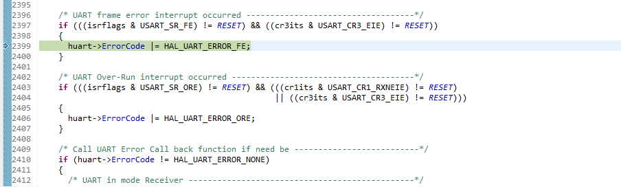

I have a feeling that his has got something to do with DMA error handling. II havent implemented any error handling for the DMA, so if the error happens the DMA will stop working. Is that correct?
2022-05-05 12:26 AM
Read out and check/post UART and relevant DMA registers content.
Do you handle UART errors (namely overrun)?
2022-05-05 12:32 AM
Currently I do not handle any errors. I am now looking into how to do this correctly.

2022-05-05 1:11 AM
If you use DMA2 Stream1 for USART6 RX access, I guess you should have some code here in order to handle DMA2 Stream1 IRQ that will happen at end of reception.
Something like :
HAL_DMA_IRQHandler(&hdma_usart6_rx);
2022-05-05 1:13 AM
The handler is enabled in MX_DMA_init function:

}So I only need to handle specific errors inside the DMA IRQ handler?

2022-05-05 1:32 AM
I have put a breakpoint on:
HAL_UART_IRQHandlerAnd I can see that the following error happends when I am sending the data:
