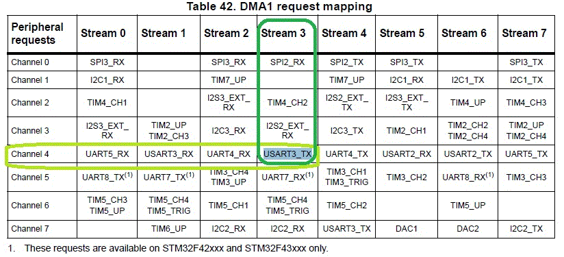

It should be:
DMA_InitStructure.DMA_Channel = DMA_Channel_4;

Yes, you would need to reconfigure the DMA transfer for each burst in Normal mode.
2014-12-18 6:40 AM
but how can I resend the data again
Yes, you should reconfigure the DMA before every transfer. At least I didn't find a good way to use it in a circular mode for transmission (for the reception it is possible). A very direct approach is to supply the address of the buffer and number of characters to a function, which will configure and enable the DMA for each transfer. If the previous transfer was not yet finished it should wait for it, which is the penalty for the simplification. A more advanced way will be an implementation of a circular buffer for transmitted characters. But because the DMA is used in a linear mode we have to manage it - when we copy the characters before the end of the buffer we set the DMA once to transmit the number of characters. When we roll back to the beginning of the buffer we set once the DMA to send the characters up to the end of the buffer and then when the DMA TC interrupt is triggered - for a second transfer for the remaining characters. Sounds a bit complicating but works :-).2014-12-18 6:59 AM
