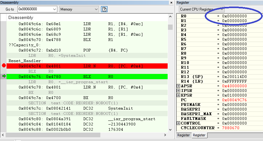

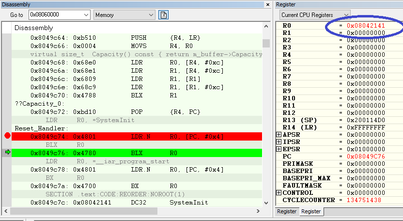

On one board, the address for R0 is loaded with the address pointing to SystemInit() before it branches indirectly to it:
On another board, R0 stays at 0x00000000, and will eventually hard-fault:
I checked the option bytes and micro controller and the two appear to be similar in revision and option byte setting.
Has anyone ever experienced this issue before; and if so, any hints on remedying it?
