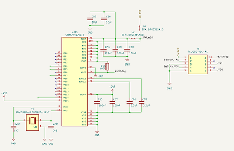

I can not post the full schematic as it is propriety, however the power supply setup is as follows:

2025-12-15 4:02 PM
Is VREF+ coming up in time to respect VDDA - VREF+ < 1.2 V? Otherwise things look okay.
VDDA/VREF+ decoupling caps don't match datasheet recommendations but I doubt that's it. No decoupling caps on VDD shown. Guessing those are somewhere. Do VDD/VDDA track each other as power comes up? They better.
2025-12-16 12:15 AM
VDD has decoupling caps and some for buffering (4x10µF, 10x100nF), the vref is a zener based voltage reference that should come fairly quickly.
What does "Do VDD/VDDA track each other as power comes up? They better." mean exactly ?

2025-12-16 12:34 AM
Settling to the nominal level at about the same time (in the micro seconds range) after power-up.
2025-12-16 4:15 AM - edited 2025-12-16 4:15 AM
That looks good enough too, I'd say. Between VDD / VDDA there's only a ferrite bead with 0.15R and then 20uF for VDDA.
Maybe you can try to raise the internal brown-out level (if possible on a F4)?
I always prefer external reset controllers if space and budget allows.
2025-12-16 5:47 AM
VDD needs to track VDDA per the datasheet. I suggest looking at these on a scope to see them come up. Adding VREF+ in there would also be smart. See the datasheet.
20 uF bulk capacitance is excessive but shouldn't be a problem. Not sure. Might be something else going on.
