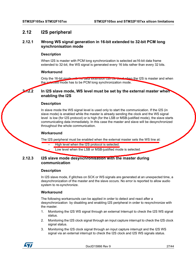

My MCU is STM32F105RB
From ES022:
2018-05-08 10:06 AM
waclawek.jan you are right.
The WS sync is correct when the I2S is enabled at WS high level.
void I2S_Fit()
{ __disable_irq(); I2S_Cmd(SPI2, DISABLE); Init_I2S(); while(!I2S_WS_IN_PIN_READ); while(I2S_WS_IN_PIN_READ); while(!I2S_WS_IN_PIN_READ); SPI2->I2SCFGR |= 0x0400;//enables I2S__enable_irq();
}The I2S interrupt timing is not exactly same with the timing of I2S clock count.
So I have not realized the I2S data is correctly received.
There is no I2S WS sync bug at STM32F105RB.
STM32F105RB is excellent MCU.
Thank you ,
waclawek.jan.
and also Thank you Albert Gonzalez.
