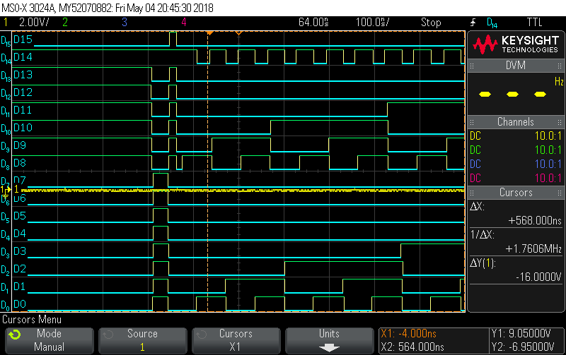

So here is what I first got with just DMA from internal RAM to FMC bus:

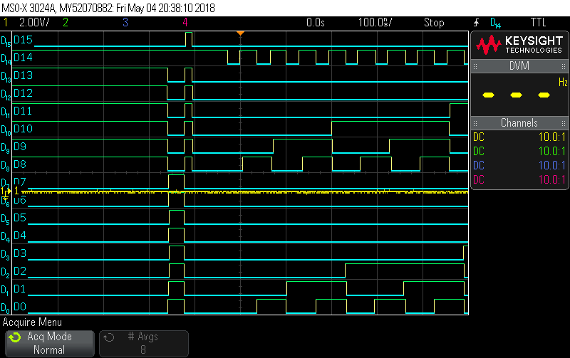

D0-D7 is data, I count from 0 to FF but split into two 128 byte blocks. D8-D13 is lower address, D14 is NWE and D15 is a GPIO signal for the FPGA. The ''glitch'' is on D8-D13 and D15 at the start of transfer. To see what was happening I removed the DMA and just used the CPU to write to the FMC. That resulted in this:

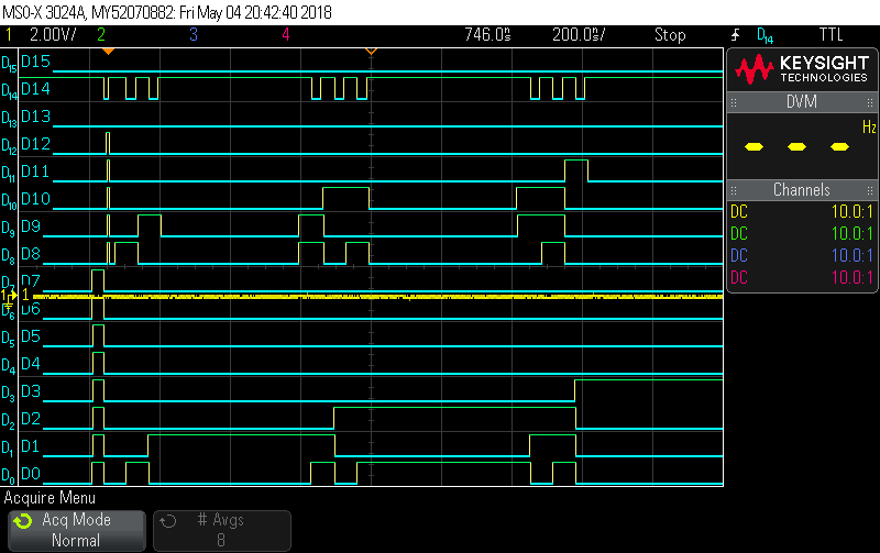

Cache is disabled for both instruction and data. Note that D15 does not glitch, but the other lines do. That might rule out cross talk (an analog problem) but maybe not. The first byte of 0 is still missing. So I then wrote 2 bytes using the CPU before firing the DMA and got it to work:
The glitch is still there, but the first DMA write is data byte 0 on address 0. The FPGA will use the address on falling edge of NWE and the data on rising edge, so this is perfect. My GPIO signal for the command is much wider so I can ignore the glitch on D15.
