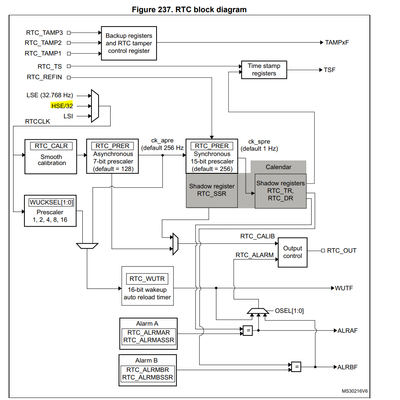

This is not true, according to RM, HSE is divided by RCC_CFGR.RTCPRE which ranges from HSE/2 to HSE/31.

Hello @waclawek.jan,
Thank you for bringing up this issue
I can already confirm that the information in the datasheet is not totally coherent with the RTC block diagram (HSE/32):
I will further look into this issue and get back to you asap
Thank you!

Hi @Sarra.S ,
Indeed, a third divider, wrong again.
I understand that it's consequence of copy/paste, but it deserves to be cleaned up.
Thanks,
Jan

Hello again @waclawek.jan,
I can confirm that The correct description is in RCC so from HSE/2 to HSE/31.
This issue is tracked internally to be corrected (Ticket 163728).
Thank you for bringing up this issue.
