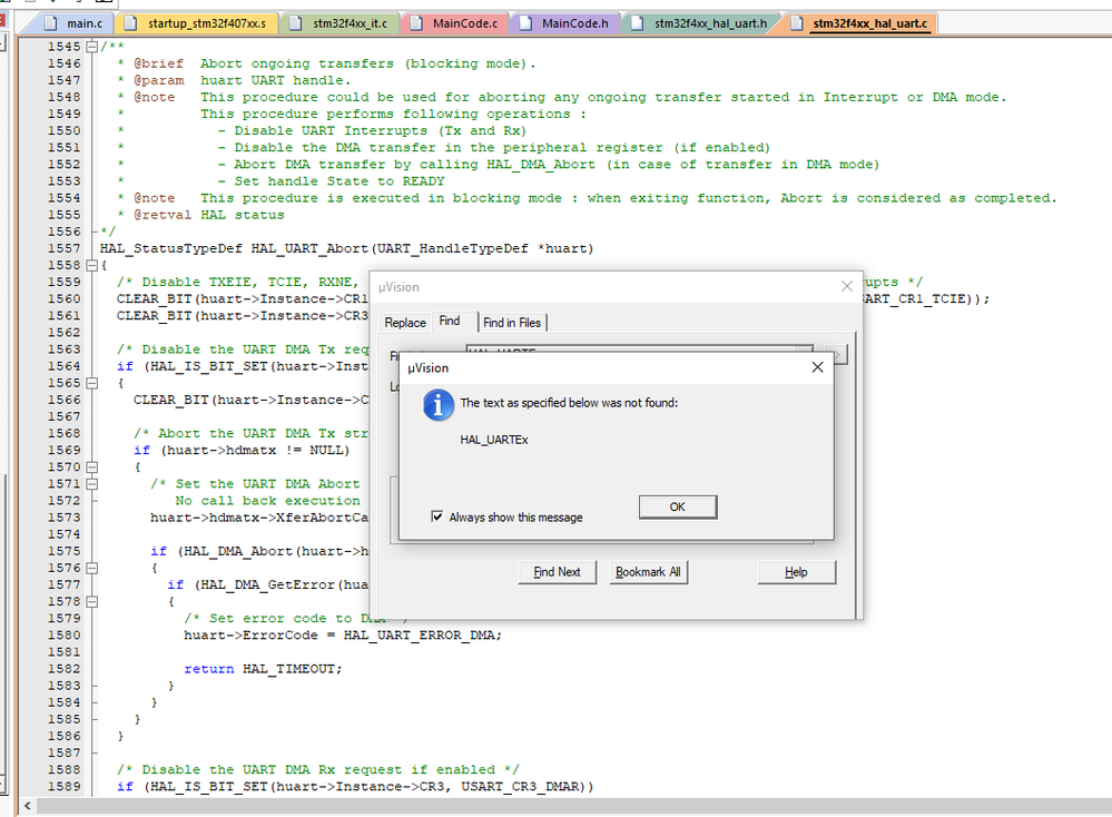

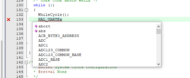

0693W00000LvWswQAF.pngIm looking into Keil Uvision IDE suggestions and stm32f4xx_hal_uart.c file which stm32cubemx generated. Ive seen that it is there on the github, but hal_uart.c which cube generated seems to be different than the one in github

You might be on a much older version of the library. It's been in there for a bit. Update embedded packages in CubeMX. You can see which library version you're using in Project Manager -> Project -> MCU and Firmware Package.

Should be a solveable problem. Ensure you're looking at a file generated by CubeMX and not one copied into a directory somewhere. Delete the file and ensure it's replaced when you generate code.

For testing purposes, just created a new cubemx project, generated fresh code into a new folder, function is still missing. Where im checking - testing if Keil Uvision can autocomplete the function based on all the funcion names in files, aswell double checked the files in /Projectfolder/Drivers/STM32F4xx_HAL_Driver/Src/ Both HAL_UART.c and HAL_USART.c - function doesnt exist anywhere.
