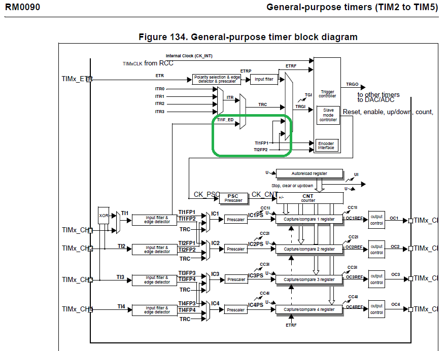

Well assuming you're using an F407 part, then that would be the Reference Manual, RM0090
The signal routing is limited, you cannot invent connectivity to suit. ''Does not route'' basically means the software/hardware to not provide a method to get from where you are, to where you want to go. This would be the salient diagram in the Reference Manual, that shows the non ETR/ITR sources for an external clock. This re-enforces the Firmware Library definitions I posted earlier.We’re moving the ST Community to a new platform to give you a better and more reliable community experience.
