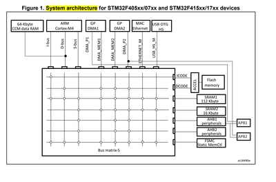

Hello @zd9797,
As you can see from the system architecture:
DMA1 does not have direct access to the APB1 bus, which is why the transfer is failing
Using TIM1, DMA2 has access to both AHB1 and APB2 buses that's why it works.
You either use a timer that's on APB2 bus, or use a different DMA stream that has access to to APB1 bus
2024-09-11 12:56 PM
Oh is that why it was failing! I brought up this issue with my senior and I was afraid of this answer.
DMA1 does not have direct access to the APB1 bus, which is why the transfer is failing - Is this intentional or a flaw?
So is there a way to know what can the DMA1 access and what it cannot?
2024-09-11 2:02 PM
There's a bus matrix diagram
DMA1 associates with peripherals on the APB1, ie access to registers, source of triggers
DMA2 associates with peripherals on the APB2, ie access to registers, source of triggers
DMA2 can also do memory-to-memory, basically a two step process, a read, then a write, rather than simple flow-thru mechanics.
This functionality has been repeatedly stated for F2 / F4 designs for well over a decade.
My correction to the earlier statement
"DMA1 does not have direct access to the AHB1 bus, which is why the transfer is failing"
It's a function of the design, to simplify the implementation.
APB1/DMA1 has internal connectivity, think points on a rail system, and can connect peripherals to/from memory. It doesn't inter-stage, so it can't go memory-to-memory, bus-to-bus,or APB1-to-APB2
