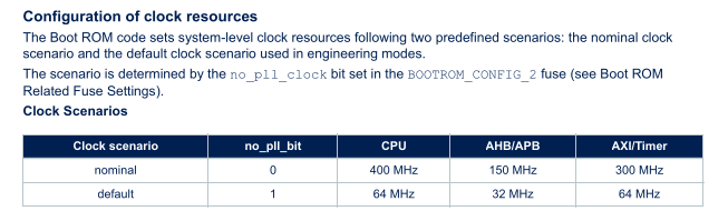

In the document UM3234 we see the following description of clock configuration
On my Nucleo board, I haven't blown any fuses and measured a clock frequency of 32 MHz. Since the XSPI is configured to have a prescaler of 2 by BOOTROM (also mentioned in UM3234), this implies that the board is using the default clock scenario. The document also mentions this regarding the nominal scenario.

By default, the Nominal mode is used by the BootROM because the no_cpu_pll bit = 0. The CPU clock is therefore 400 MHz.
However, in Table 25 the value per_ck = 400 MHz is incorrect for the Nominal column. It should be per_ck: hsi_ck = 64 MHz (same configuration in Nominal and Default) (fix planned for the end of April 2026).
Moreover, XSPI1_P2 is configured with a prescaler DIV2, so XSPI1 ultimately operates at a clock of 64/2 = 32 MHz.

If the fuse configuration is left at its default value and the measured CPU frequency is 32MHz, the device is running from the HSI clock source. In this case, the device is not in secure boot mode; it is operating in development boot mode.
In development boot mode, the CPU PLL is never enabled, regardless of the no_cpu_pll fuse setting.
When secure boot mode is selected (flash boot or serial boot), the CPU frequency is determined by the no_cpu_pll fuse:
no_cpu_pll = 0: nominal CPU clock =400MHz (PLL enabled).no_cpu_pll = 1: CPU clock =64MHz (HSI)."Does this mean that if i dont have secure boot enabled yet, ill get the default clock,"
This depends on what is meant by “secure boot mode is not enabled.” If it refers to the boot pin selection being set to development boot mode, then yes: in this mode the PLL is not used and the HSI clock source is selected for the CPU.
