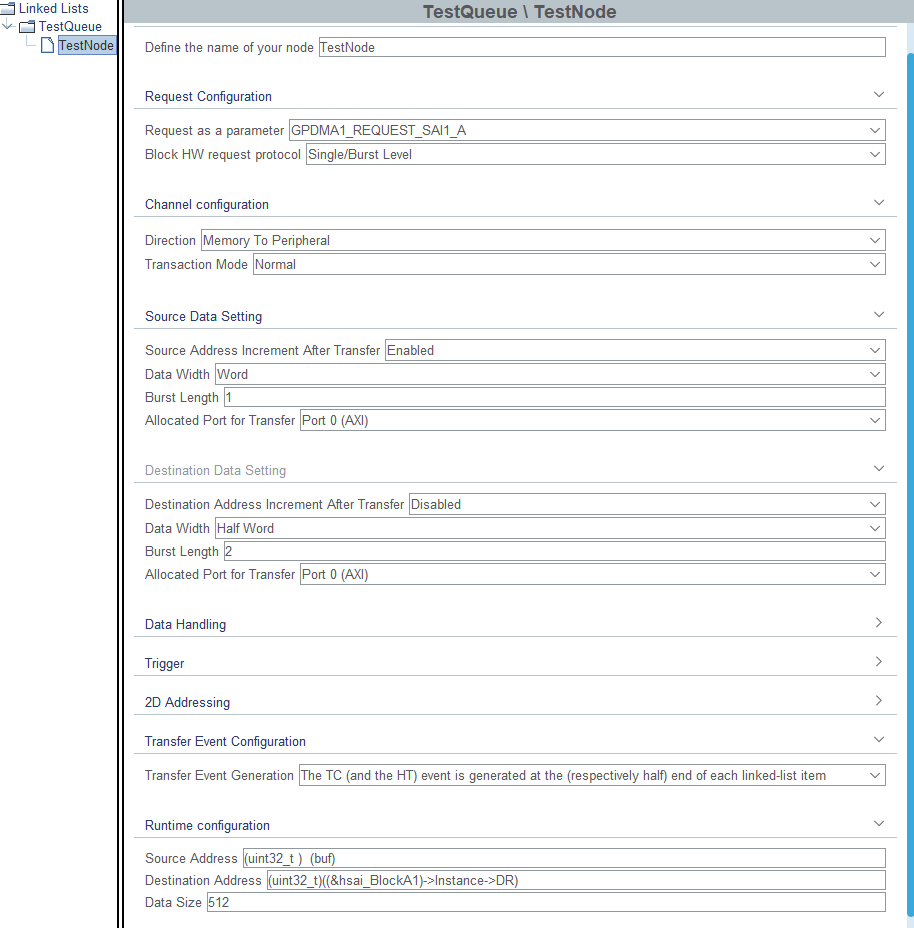

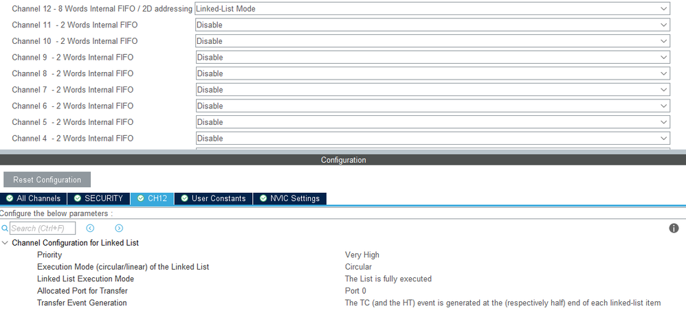

Using a NUCLEO H7S3L8, I'm trying to run a test where, using circular DMA with a linked list, I'm trying to send a buffer in memory over to the SAI for audio playback, using an external DAC. This configuration is based on either other tutorials or the reference manual, but it always throws a User Error flag and calls the DMA's IRQ handler, right after the HAL_DMAEx_List_Start_IT() call (whether done on its own after the necessary configuration, or as part of HAL_SAI_Transmit_DMA()).
Even with some changes, it always yields the same results. The only one that seemed to have any effect was setting the Transfer Event mode to trigger the TC flag for each linked list item, which confirmed that a transfer might have been completed, despite the error flag.
I have also seen GPDMA being configured with circular, using both Standard Request Mode and a Linked List, but haven't gotten any success out of that myself (with even TC flag not being raised).
In case it causes any complications, the board also is configured as a USB Audio device (leftover from previous test, not used currently), and the SAI is configured at 16 bits, at 48 kHz.
Below are images of the configuration:
I'll also leave main.c of the application project, where the only parts of relevant user code have been written.
Any help or advice would be greatly appreciated.

Yes, it does work now. And checking the changed settings one by one, it looks like the main culprit was D-Cache being on. It seems that just putting the buffer that will be used for the DMA transmission in a non-cacheable area, as declared by the CubeMX linker script, isn't enough for circular mode using GPDMA.

After i got it to same state as you had, it seemed a problem with the data size and the DMA.
And so i switched off d-cache, to exclude any problems from this side, and the MPU (because useless then).
In my "experiments " for my player i also had to tinker around for a few hours, to get the linked list working, so i know the "problems" (this beast is so complex and together with the SAI and its fifo ...still more).
So i changed data type to int16, what usually the standard PCM is and a DAC expects to get;
then let the DMA do the job to do the fifo loading in its optimum format, for fastest transfer;
and reduce its priority, as its not needed here (audio data rate is "slow" for this kind of cpu, and together with the fifo there will never be a delay/dropout problem, so better to have the (maybe) needed fast things, like interrupts from other signals, working with higher prio.
And about the d-cache: just leave it off, if not needing the last few percent of performance, the cpu can have at all.
