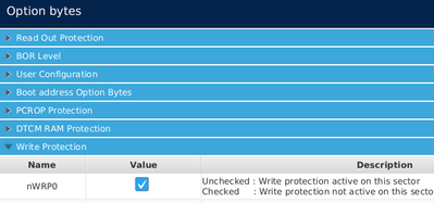

maybe you (your cpu) have some write protection on , check in STM32CubeProgrammer :
Check: erase is on:
And try full chip erase , if still wrong.

Hi AScha.3
The first option, where I an find? The second option, I using in that way and I can found de error with that option. When I debug the code, it's never call the function MEM_If_Erase_HS so, it can't write the new code because it need all memory erased.
