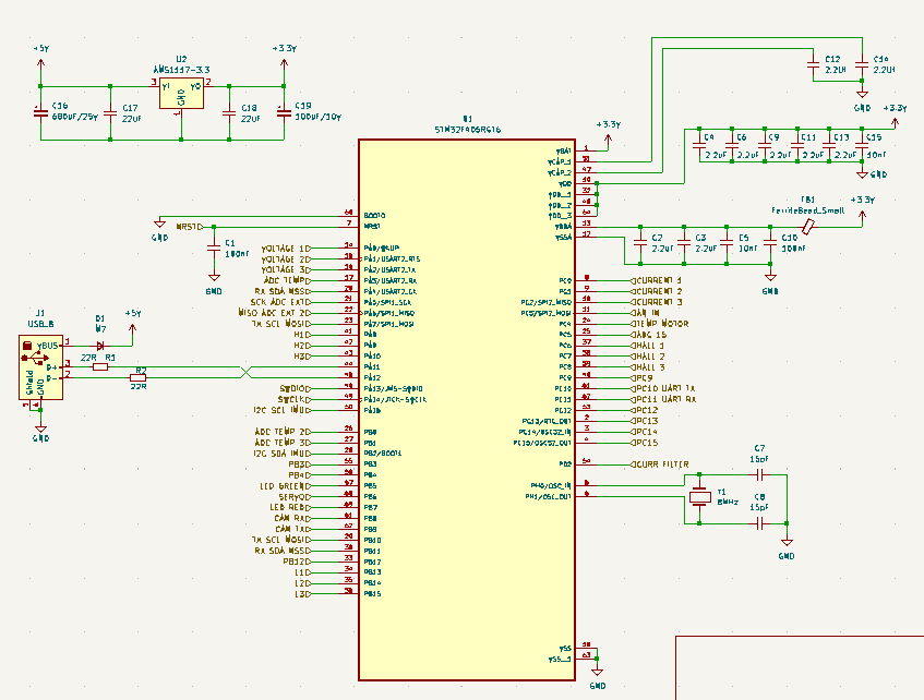

I am trying to create a BLDC Controller project based on VESC using the STM32F405RGT6 microcontroller. I have successfully flashed the bootloader and uploaded the firmware using STLink. However, when I connect the IC to my laptop via USB, the IC is detected and can run the firmware only for a few moments (around 2 minutes) before disconnecting. What could be the issue?

Pulling too much power or reseting. Perhaps scope supply vs NRST

Check the output of the AMS1117-3.3 voltage regulator. If the regulator overheats or becomes unstable, the microcontroller could reset or disconnect.

Ordinary lockup of USB stack due to calling transmit routine from the main loop?... Just wild guess, not really enough info for a reasonable answer.
