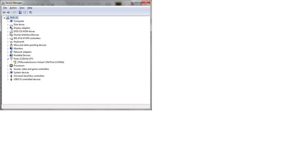

2018-01-01 10:53 PM
After installing the virtual com port driver till i faced this issue.
Driver not installed properly.

2018-01-02 6:41 AM
Try navigating to C:\Program Files (x86)\STMicroelectronics\Software\Virtual comport driver\Win8
and double click on dpinst_amd64.exe (for 64bit windows) or dpinst_x86.exe (for 32 bit windows), then try again.
