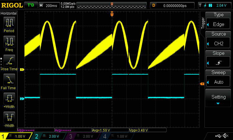

I want to change the array who sources the DMA, and I can't,
I don't Cube but having a cursory look at HAL_TIM_PWM_Stop_DMA() it appears that it does not stop DMA itself, only disables the trigger in timer.
If you want to change the memory pointer in DMA you can do that only if you disable the given DMA channel (or in double-buffer mode you can change the 'other' address, but that's not what you want). I don't know how to do it in Cube - this is exactly the reason why I don't use it.

The HAL_TIM_PWM_Stop_DMA() it's not a Cube thing, but a HAL thing, when I generate the code with Cube it not even put the function HAL_TIM_PWM_Start_DMA().
I didn't look it before, but now I can disagree with you. I was debugging the process step by step and when we reach the function HAL_TIM_PWM_Stop_DMA(), we are going here:

}Then when I reach the bold function the DMA stops flushing numbers into CC1 (the pwm remains where it is), and when the function , TIM_CCxNChannelCmd(htim->,Instance, Channel, TIM_CCxN_DISABLE), is processed then the pwm goes down.

what else is needed to unlink the DMA from the current array? I tried with multidimensional array too, with the same result.
also, I don't know about the double buffer you say, where I can read more? I'm looking for a way to generate the array on the fly (because I will need many, and the memory will be not enough), and then change the array for the next step of the waveform. Thanks for your time!

Fantastic!
changing the loop to this it works:
while (1)
{ HAL_Delay(500); if (act_seg == 0) { act_seg = 1; HAL_GPIO_WritePin(LD2_GPIO_Port, LD2_Pin, act_seg); HAL_TIM_PWM_Stop_DMA (&htim3, TIM_CHANNEL_1); hdma_tim3_ch1_trig.Instance->M0AR = 0;HAL_TIM_PWM_Start_DMA(&htim3, TIM_CHANNEL_1, (uint32_t *) seg0, 8192);
else { act_seg = 0; HAL_GPIO_WritePin(LD2_GPIO_Port, LD2_Pin, act_seg); HAL_TIM_PWM_Stop_DMA (&htim3, TIM_CHANNEL_1); hdma_tim3_ch1_trig.Instance->M0AR = 0;HAL_TIM_PWM_Start_DMA(&htim3, TIM_CHANNEL_1, (uint32_t *) seg1, 8192);
Now I need to see the double buffer thing, seems interesting too. Thanks again!
