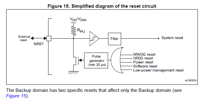

NRST pin pulled up hard?
2020-11-04 11:43 AM
Yes, it is connected to an external reset control chip which probably keeps that pin held high - would that keep it from resetting? I didn't think a watchdog reset would actually try and pull down that pin.
2020-11-04 12:12 PM
You are right, the reset circuit diagram does suggest that holding that pin high would prevent a reset. Thanks for the suggestion, I believe this is the problem.

Driving it high with a push-pull is a problem, you can have multiple reset sources, but they need to use open-drain
