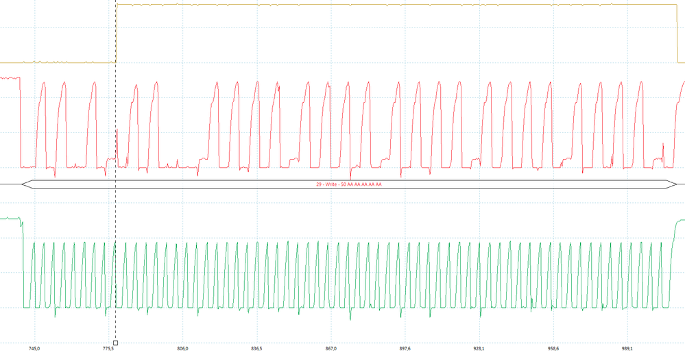

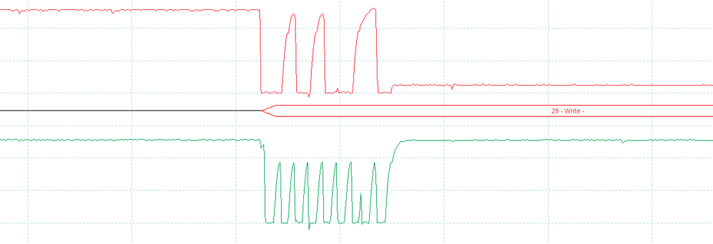

This one shows a pin triggered by the ADDR-Interrupt (yellow), as you can see, the interrupt gets triggered right after clk-pulse 9.
When just looking at it it seems like the master notices that the clk was not sent correctly (first image), as it tries to send the last bit again? The adress byte is supposed to be 0b01010010. If the master took all the clk pulses as valid (even the little one), this one would be 0b01010011. Nevertheless, the slave problem needs to get solved itself, as it could crash the bus.
