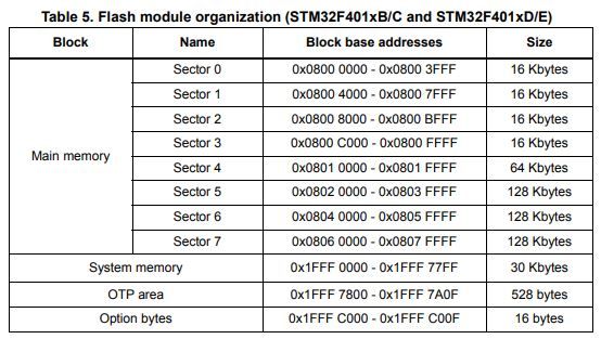

We have STM32F401VET6 in our product development. Currently, our project (makefile) compiles and stores application binary in STM MCU internal flash. We would like to store three other binary/hex files to the STM MCU internal flash as part of the building (makefile) of the project. We intend to store some other sub-components FW binaries in STM MCU's flash and use them during product use.
As we can see that flash address space is divided in the below table,
we would like to have 4 partitions as follows:-
During the product use, if Component 1 needs to be updated, STM MCU will just read binary starting from 0x0806 0000 to write its FW. Similarly other two components will be updated.
Can somebody provide a way to the update the building of a project in this manner so that the flash gets written in that manner.

Going to be hard to have multiple independent components share a page of flash effectively and update them independently. Since they share a page of flash, you would need to read out page, erase it, and rewrite all components.
You could modify the linker file and place code into specific sections, but in order to update those without affecting the rest of the program, you're going to need a lookup table which tells the main program where each function is within the flash, or fix them to specific locations. Not something I would recommend.

Generally people don't split the 128KB flash sectors in this way as they can only be erased as a whole.
Consider if you can better manage the low range smaller sectors to hold these things, they will be a lot easier to replace individually.

@JSaro.1 Note that your components 1,2,3 occupy parts of one 128K erase block.
To rewrite only one of them you will have to erase the whole block and save somewhere other two components.
So, you'll want to change the layout:
At the start address 0x08000000 should be a small "bootloader" or startup code that jumps to the main binary.
This boot code will take a part of component1.
--pa
