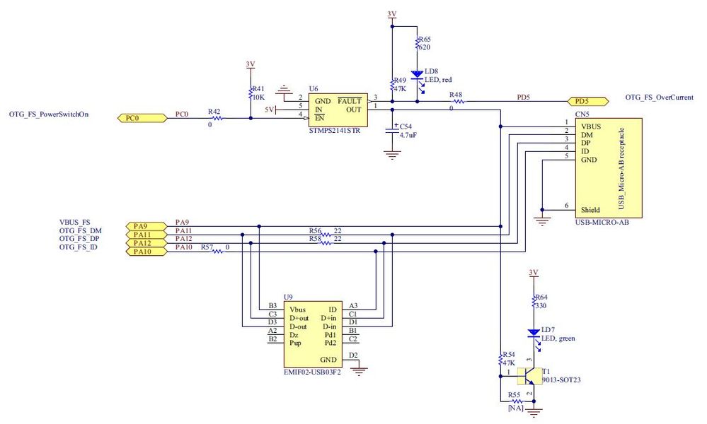

Check the discovery board schematics around USB. Some USB IP versions need external pull-up resistors while others have it programmable internally. Check also if this device requires a precise external clock to operate as device. Internally the macrocell needs to generate 48MHz for the USB cell.
2017-03-28 4:12 AM
Hi, I'm very sorry for my delay and thank you for your interest.
I carefully considered the USB schematic of the STMF401 discovery board. On page 35 I see the USB_OTG_FS section
The difference in my implementation is that I have no 22ohm series resistors on the lines PA11 and PA12, I have no EMIF02-USB03F2 for the ESD protection and I have no STMPS2141STR circuitry on VBUS (the latter because my board has to work only as device and not as host). In other words, in my implementation, the pins of the STM32 are directly connected to the USB plug.

2017-03-29 4:21 AM
I solved!!!!!
The problem was I didn't connect the shield of the USB plug to GND.
