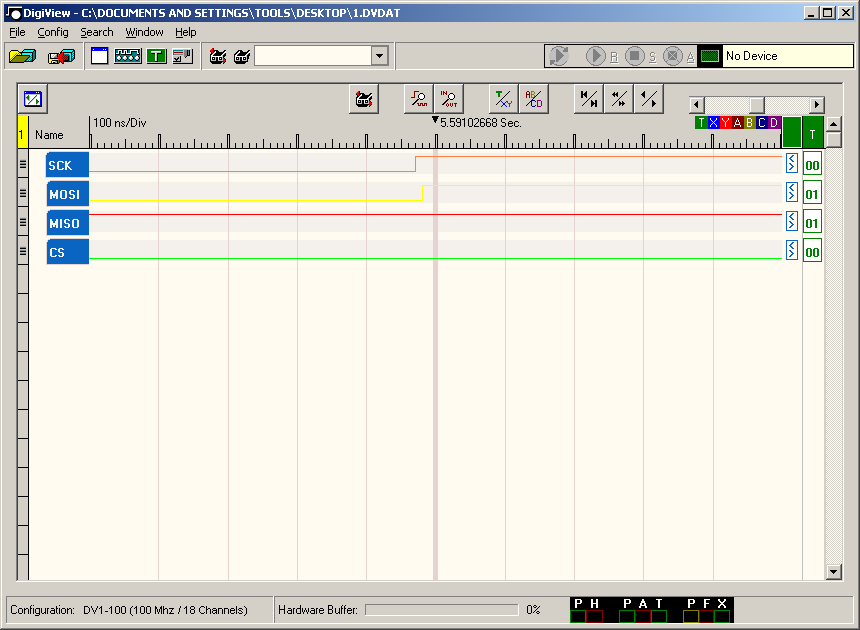

After sending some bytes on MOSI. On logic analyzer, I see clock and MOSI data are mismatched.
This is a very zoomed in pic, If required I can send the whole logic analyzer file.

Hi singh.ishmeet,
Can you provide the HAL_SPI_MspInit() API and the snapshot of the first SPI transmitted byte ? That would help more easily figure out where a problem could be.In fact, what we see on the logic analyzer is just the SPI GPIO configuration, and not “the clock not synchronized with MOSIâ€�, this is just the SLK I/O already configured before the MOSI I/O (the clock for data is not yet generated on SLK I/O).Regards.We’re moving the ST Community to a new platform to give you a better and more reliable community experience.
