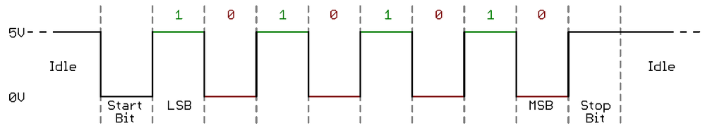

2025-10-22 6:52 AM - edited 2025-10-22 8:06 AM
A stop bit is indistinguishable from a line idle condition.
So, as long as the line remains idle for at least the required number of "stop bit" periods, it doesn't matter.
This is standard UART behaviour - nothing specific to STM32.

PS:
See also this Serial Communication tutorial from Sparkfun. It illustrates how the stop bit state is the same as the line idle state:

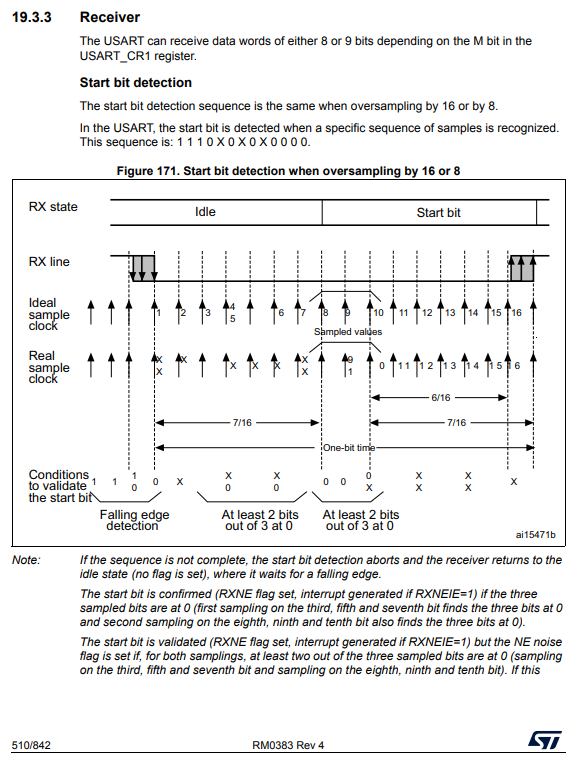

@LS813 wrote:Can anyone teach me how STM32F401 receives UART things?
A full description of the UART operation is in the Reference Manual - RM0383:

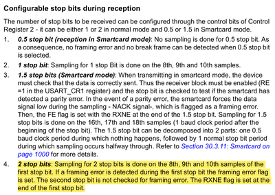

Why not set them to the same settings?
This is covered in the reference manual. It looks like the second stop bit doesn't have any checking associated with it and will receive correctly in this case.
